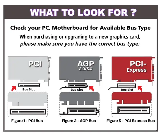

Let's assume that the video card is compatible with your motherboard, this is that the video card will fit in the slot for the video card on your computer's motherboard.
To be sure, you will need to check your computer's manufacture's site and check that the video card you have can work on your motherboard, or see the image that is below
If  so, you will need to have the driver CD, or driver file downloaded of the video card, for installing it after connecting the video card.
You will have first to turn your computer off. Unplug it from the outlet. Open the computer by removing the top or back cover. Install the video card, aligning it with the video card connector. Here is an image with the different types you can find.
        IMAGES-OF-DIFFERENT-CARDS-SLOTS
