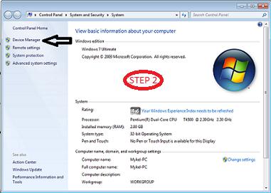

Hi Joralyn,
I Have the solution in your USB port problem
Step 1:Go to your "Computer" icon on your desktop and press right click then left click the "PROPERTIES" (it will open the system window of your computer)
Step 2: Once you have opened your system window left click "DEVICE MANAGER" (it will open your device manager window) in the device manager window you will see an icon there that looks like a USB plug named "UNIVERSAL SERIAL BUS CONTROLLERS" double click the "universal serial bus controllers" and a drop down list will open you will see the "USB ROOT HUBS" , that is your USB ports.
FOR EXAMPLE:
I have 3 slots of USB ports on my laptop so there are 3 "USB ROOT HUBS" on my "universal serial bus controllers"
so if you have 4 slots of USB ports on your Desktop or laptop there will be 4 USB ROOT HUBS" on your "universal serial bus controllers"
Step 3:(disabling the USB port hubs so your customers cant copy any files from you) Right click the first USB ROOT HUBS on drop down list and left click "DISABLE" (that USB port will not work anymore) if you want to disable all your USB ports then go ahead and disable the other "USB ROOT HUBS"Â on your PC.
And if you want to use your USB port again right click on the "USB ROOT HUBS" and left click "ENABLE"
This is the easiest way to disable your UBS PORTS and the most easiest way to enable them back again.
I hope this helps and more power to your business.
Michael F.
STEPS 1-3 pics. below
BTW you have to be logged in, for you to see the Steps 1-3 pictures
