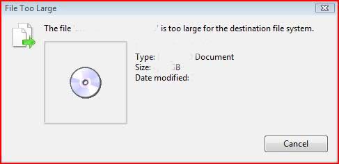

I have a FAT32 external hard drive with me.
I am trying to copy a file into it, but I realized that it won't allow me to do it, if the file is 4 GB or so.
I need to copy two image files with a total of 6 GB, but the external hard disk is showing an error while I am trying to transfer it. It says:
The file is too large for the destination file system.
I think that I need a file splitter, but my question is what will happen if I split the files, to make the size lower than the original size? And if I split my files, can I rebuild it back, to make it just a single file again? How can I reformat the external hard drive again, to NTFS? I am using a Verbatim USB Portable Hard Drive, with 250 GB spaces on it and I will run it on my Windows Vista Home Premium Service Pack 2.

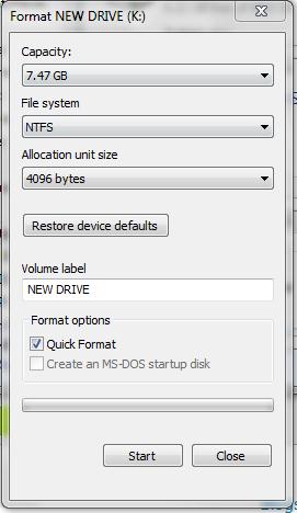

It is the limitation of FAT32 file system. It is limited to file size up to 3.99GB only. To copy larger files into a drive, you need to format it using NTFS file system.
To format it into NTFS, you have to right click on the drive in my computer and select format. Then select NTFS in the file system menu in the format drive options.

If you decide to convert to NTFS, you can simply go to My Computer (or just Computer for Windows 7).
Right-click on your hard drive and then select Format. Choose NTFS for File System and then start reformat.

You all are geniuses! I successfully format it into NTFS. Thank you very much! Techyv is really a great site.
