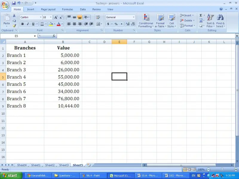

As you mentioned in your question I took some data.

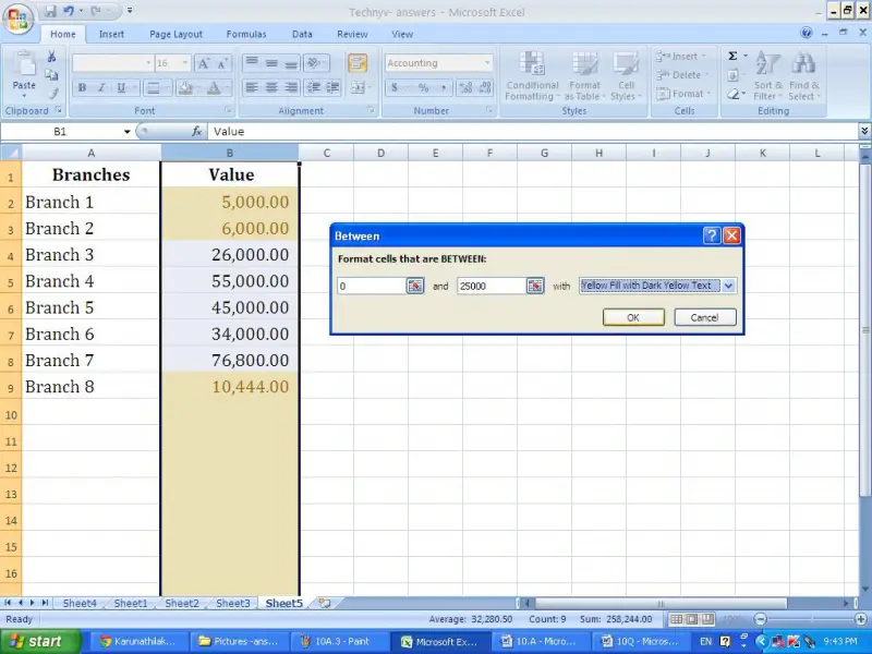

In the next window, type “0” to first white box and “25000” to next white box.
Then Select “Yellow fill with dark Yellow Text”, from the “with” drop down list and click ok.

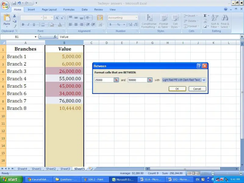

Again follow the same steps and type 25000 in the first white box and 50000 in the next white box.
Then Select “Light Red fill with dark Red Text”, from the “with” drop down list and click ok.

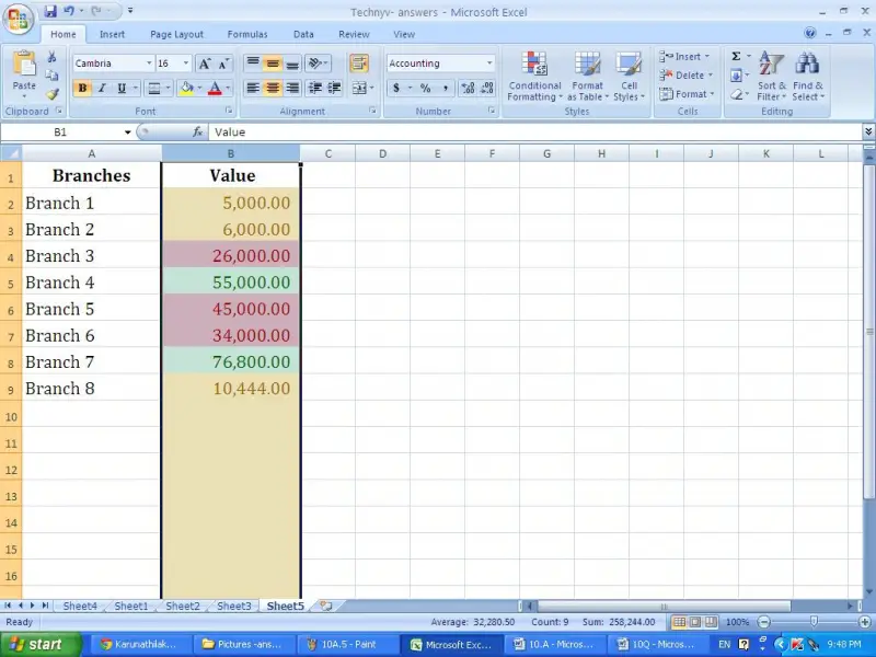

Again do the same thing and take values as 50000 and 1000000.Select “Green fill with dark Green Text”.
MS Excel Conditional Formating
Now your answer is complete.

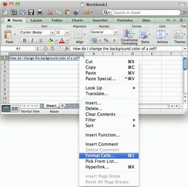

First right click the particular cell, and select Format cells from the drop down menu.

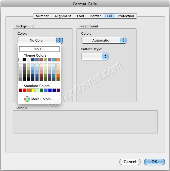

When the format window opens select fill tab,
Format Cell
There you can select the color you want to apply and then click ok.
