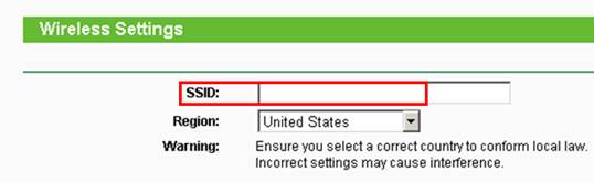

On the SSID section name the router.

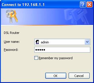

2. Connect your PC to another LAN port with the use of the Ethernet cable. Login to TP-LINK through the IP address found at the bottom label. To do this,launch your browser and then type the LAN IP address. The default IP is 192.168.1.1 and then press the Enter key.
If you cannot access this IP address, check or reconfigure your PC's IP address. Then type the username and password in the login page. The default username and password is "admin".

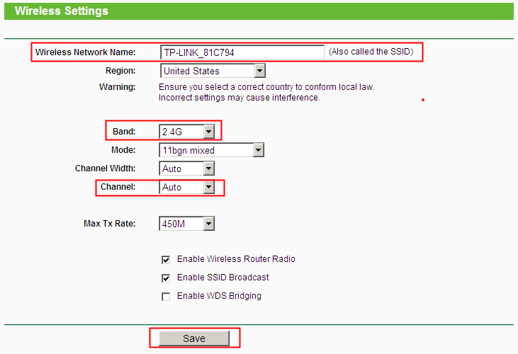

4. Configure your wireless settings by going into Wireless then Wireless Settings page. Configure the SSID and the Channel. If you are using a dual band device, choose Band and click Save.

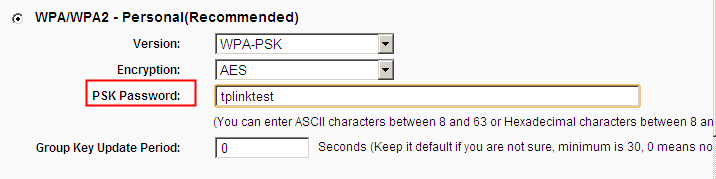

Then go to Wireless and Wireless Security page and configure your wireless security. TP-Link requires WPA-PSK/AES and the PSK Password will be the key of your wireless.

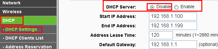

5. On the menu to the left side, click DHCP option and disable DHCP Server and then Save it.

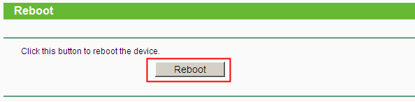

6. Under System Tools, go to Reboot page and click the Reboot button.
