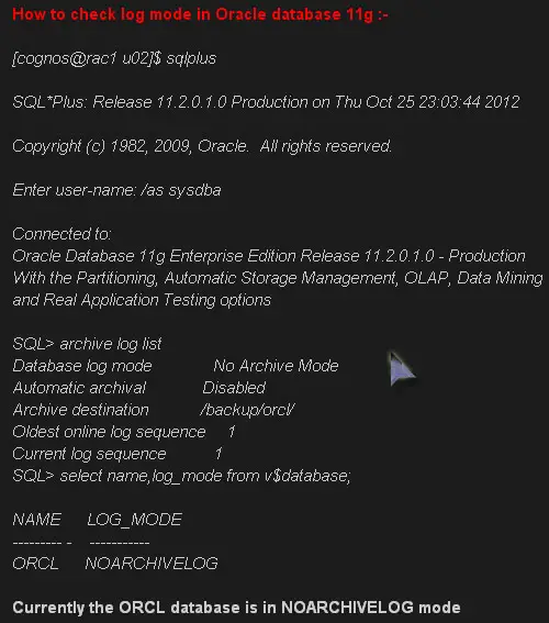

To do this, you need to check first the log mode in Oracle database. See image below.

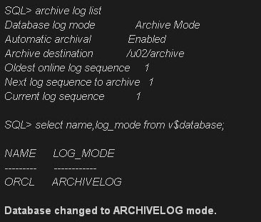

In the image above, it shows that the database is in NOARCHIVELOG mode. There are 2 types of logging modes in Oracle database: ARCHIVELOG and NOARCHIVELOG. To change to ARCHIVELOG mode, do these. First, if you require, you can set the archive log destination to where you want to save the archive logs whether to multiple locations or to a single location.
If this is not set, Oracle will save the archive log files in DB_RECOVERY_FILE_DEST location if it is set. But if you haven’t set yet your DB_RECOVERY_FILE_DEST location, you must set your archive location before changing your database to ARCHIVELOG mode. See image.

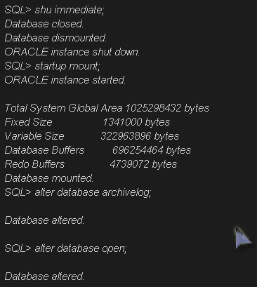

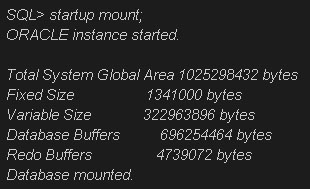

Take note, “to change this parameter while database is open, your database has to run with SPFILE, if running through PFILE then shut down your database and make changes in your PFILE and then start the database in MOUNT mode using that changed PFILE”, according to amit7oracledba.blogspot.in. Once this is done, you must shut down your database and restart in MOUNT mode. See image.

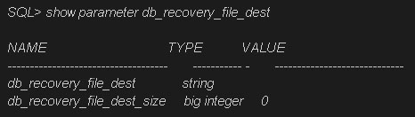

In the image, Flashback is currently disabled. To enable, set first db_recovery_file_dest_size initialization parameter.

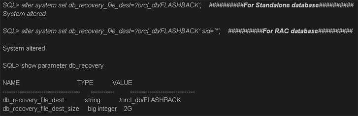

Once db_recovery_file_dest_size parameter has been set, create a location in your operating system where FLASHBACK logs will be stored.
After that, set db_recovery_file_dest initialization parameter.

Next, shut down your database.
Next, restart your database in MOUNT mode.

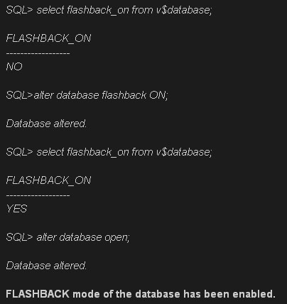

Finally, change the Flashback mode of the database.
And you are done. Flashback is now enabled in your database.
