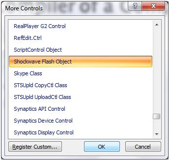

Well in Office 2007, you can add a Flash object easily. Enable the developer tab ribbon from PowerPoint options. Just go to the developer tab and click the “more controls” button. Drag to set the location of the Flash object.
When you are done with dragging, you should see some wizard like this:

When you are done by dragging, you should see some wizard like this:
Shockwave Flash Object
Select Shockwave Flash object.
Later on the properties inspector, “right click” -> properties, set the movies field with the whole path to your Flash movie.
