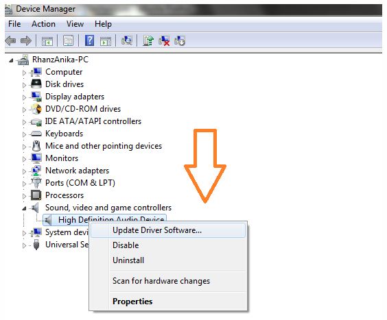

Go to DEVICE MANAGER (Control Panel+System and Security+System)
Or PUSH control key and pause/break button.
Click to Device Manger.
Then Find and Select the selected item below and RIGHT click.
Assuming that the DRIVER is the SOUND CARD you put.
UPDATE DRIVER SOFTWARE
and choose "SEARCH AUTOMATICALLY IN THE INTERNET".
Wait for the Response.
Then there you go.
"NO INSTALLER NEEDED".

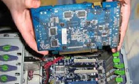

Video Card or Graphics Card is important hardware components of a computer, this display thousands of images and colours.
The clearness, brightness of computer monitor relay on the quality of your VGA card.
Here are the steps to install:
To install the video card, just follow the steps below :
1. Turn off your computer and remove the case on your CPU.
2. Remove all the screws that attach your video card.
3. Your computer either has a PCI-Express slot or AGP slot. Below is an image of the video card, and it will only fit on the video card slot, so you can’t put it somewhere else.
4. Insert the new video card into the slot. Gently press on it until it fits in the slot.
5. Connect any power connector to the back of the video card. Some video cards don’t have one, but some have one or two.
6. Turn your computer on, and you will see a BIOS message stating that a video card has been installed/changed.
7. Install the video card driver.
