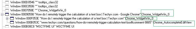

The window class of an active window can be taken by using "Spy++". This tool is shipped with Microsoft Visual Studio. Spy++ shows all the windows' handles of all active applications on your desktop. If you know the title of the window, do a search on the result. The corresponding active class name is displayed right after the title.
The following screenshot displays the windows currently active on my desktop. Notice the title of the Google Chrome application and its corresponding windows class name. The class name will differ from application to application. Please note that you may come across unexpected class names such as "#32323", but these are actually valid class names as presented to the Microsoft Windows Operating System. I have circled in green the corresponding window class name in the Spy++ output of the screen shot.

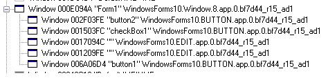

Using SPY++, you can get the class name of a currently running application. You will need to use the title text in order to get the correct window. Having done that, you need to be aware that apart from the windows handle the class name is constant for all the text boxes on the screen.
If you are attempting to target a specific instance, you need to do a loop and obtain the handles of all controls of a specified class to a list. The list index position will correspond to the correct instance position. The position of the text box handle does not change on each application instance. Therefore it is safe to collect the handles when you enumerate the current windows into a list and refer it by the indexed position.
I have attached a screen shot of the SPY++ output for the previous posting. You will notice that there are two text box instances. Each "position" is a constant on each application invocation. Therefore you can target the respective handle by getting the index position of the collected handles.
