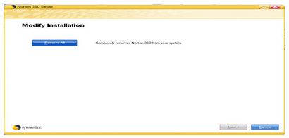

This the way how to remove Norton 360 to your personal computer. First,  click the Start, then go to Control Panel. Double click the Add or Remove program, then find the Symantec or Norton product listed and click on it. This image will appear.
Click the Remove and You'll see an image like this.
Click the Remove All button to start removal process. If removal process completes, restart the computer and Reboot at that time. After Rebooting Norton should be removed to your system.
