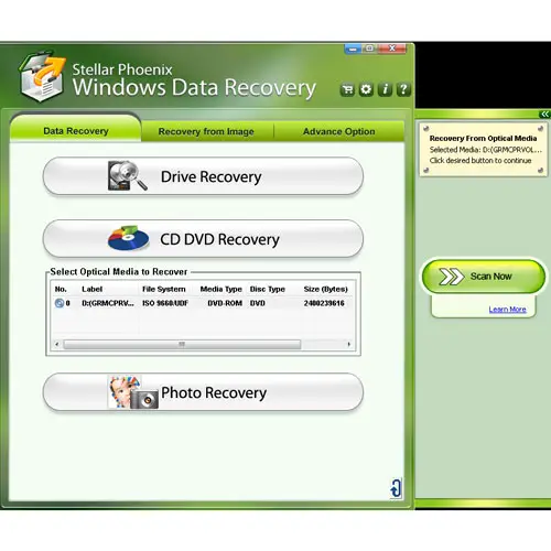

A program that will help with recovering your files and that is the most highly rated program is Stellar Phoenix
  • Easy to use.
  • Just download and install the program
  • Select driver recovery
  • Select the drive where the recovered files should be stored
  • Then click scan now.
