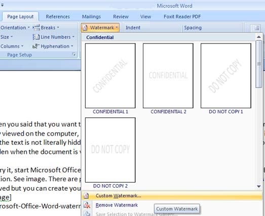

To try it, start Microsoft Office Word. Select Page Layout tab then click Watermark in Page Background section. See image. There are pre-set watermarks that will be visible when the document is printed or viewed but you can create your own customized watermark. Select Custom Watermark.

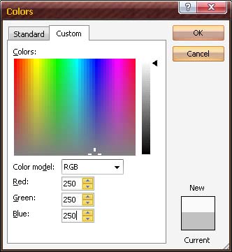

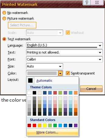

Select “Text watermark” then type the watermark text in the Text field, like for example, “Printing is not allowed.” Adjust the color of the text to be very light that it is almost invisible. You can also use the custom color option to make the color very light. To do this, in Color, click on the dropdown menu then select More Colors. Select Custom tab. In “Color model”, select RGB. Change the value of Red, Green, and Blue to 250 then click OK.
In the RGB format, the maximum value that can be used is 255. That’s why when you set all three colors to 255 will produce white. Create a sample print of the document. Adjust the color of the watermark text until it is dark enough to appear when it is printed but light enough to remain invisible when viewed on the computer.
