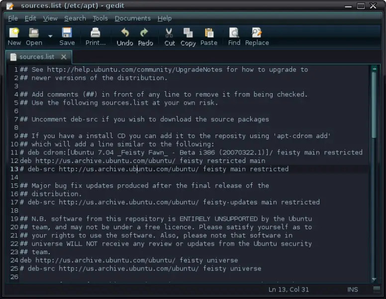

Open Gedit as root and check your repository lists. To to so in terminal type sudo gedit and press enter. Gedit will jump up and now go to Open and navigate to File system, etc, apt and open sources.list.
Check for additional repositories like Chrome repository. Maybe some of them don`t have GPG signed keys on your system and that causes the error. Also if you have many ppa and backports, remove them. They can cause system usability. Restore to default Trusted software providers in Authentication tab of Update Manager settings and run apt-get update to revert source.list. Now you can update Ubuntu.
