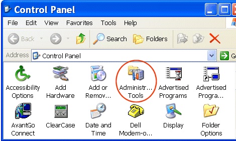

  1. Go to start > and click control panel.
  2. In control panel click the administrative tools.

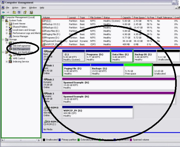

  1. In the administrative tools, double click computer management.
  2. In computer management click the disk management.
  3. Now you will see all the hard drives on the PC including your hard disk.
Computer management
Just choose your hard disk and right click to it and delete its partition, and then right click again to the hard disk and create a new partition, the dialog box will appear, just check the format and its automatically format your hard disk after you close the dialog.
