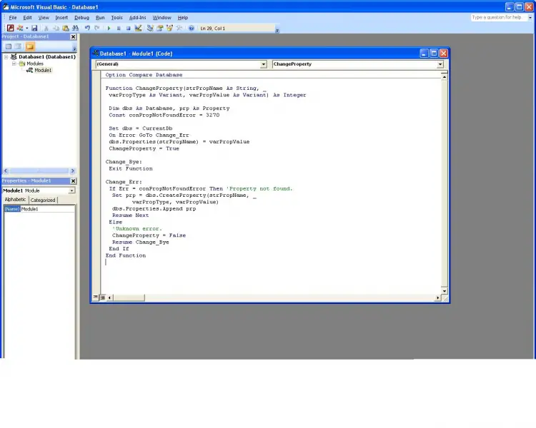

1. Create a module and paste this code:
Function ChangeProperty(strPropName As String, varPropType As Variant, varPropValue As Variant) As Integer
Dim dbs As Database, prp As Property
Const conPropNotFoundError = 3270
Set dbs = CurrentDb
On Error GoTo Change_Err
dbs.Properties(strPropName) = varPropValue
ChangeProperty = True
Change_Bye:
Exit Function
Change_Err:
 If Err = conPropNotFoundError Then
  Set prp = dbs.CreateProperty(strPropName, _
        varPropType, varPropValue)
  dbs.Properties.Append prp
  Resume Next
 Else
  ChangeProperty = False
  Resume Change_Bye
 End If
End Function
2. Save the module.
