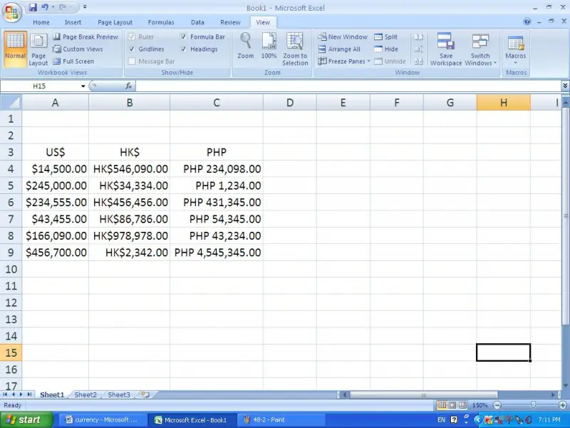

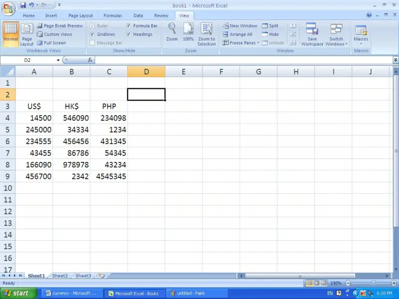

In the following image shows the amounts which should show from the three currencies.

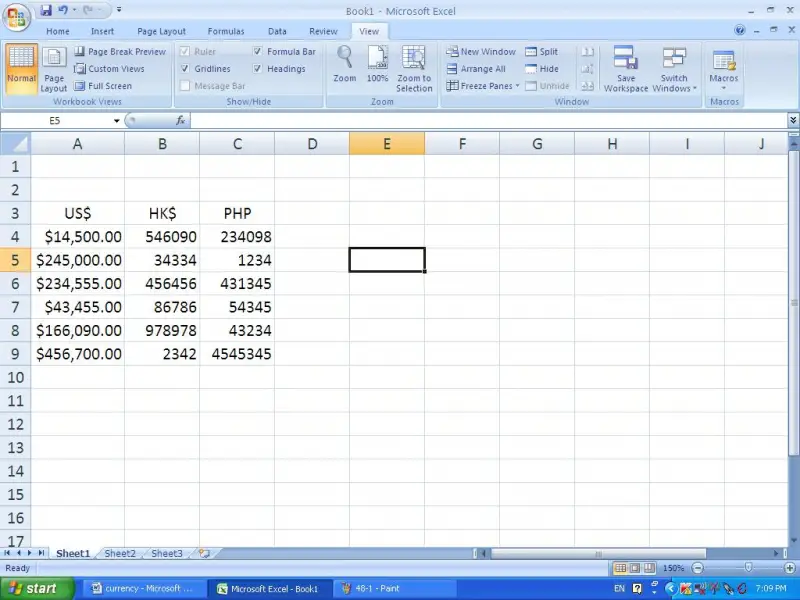

Now select the first column and right click on the selected area.
Click on the format cell and again click on the currency option in the number tab.
Select the decimal places that you want and select the currency type you want in symbol.
Now click ok.
Do the same thing to the next columns and select the other currency format.
Now you can have the amounts in three currencies as follows.
