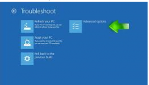

You can solve this difficulty by following steps given below:
1. Press and hold the shift key.
2. Click on start menu and press the restart icon while holding the shift key.
3. The dialog window will appear.
4. Choose Troubleshoot option.
5. Click on Advanced option.
6. Now select the startup repair option.
7. You will be guided from there.
