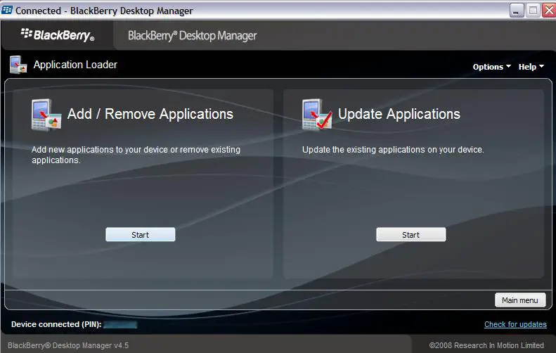

1. After the Software has recognized your smartphone click on application loader.
2. Then this screen will come up, choose Add/Remove Applications

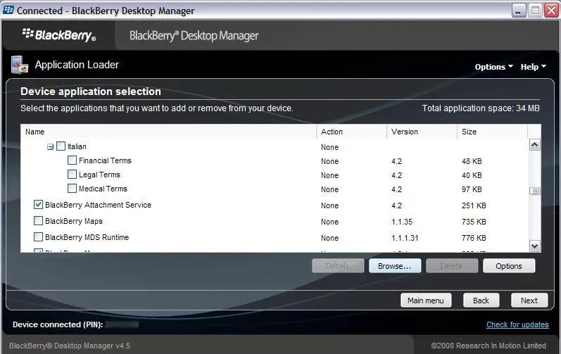

3. This will be the next screen. Then click browse, select the file for your theme it usually has the .alx extension. Then click next.
4. You will now go back to the app loader screen, here you can see the theme/app you want to install and all the other installed app on your smartphone. Do not uncheck anything for it will remove that unchecked application. Then click next.

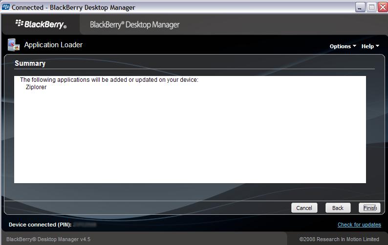

5. The next screen you will see is the summary of all the action going to be performed to your smartphone. Then click finish.
