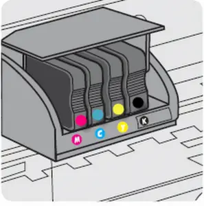

Step 3: Take out the Ink cartridges.
Remove the cartridges carefully, and then check the printer display panel for an error message.

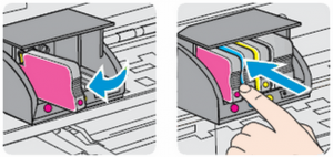

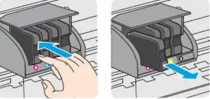

  • Open the cartridge access flap.
  • Wait for the carriage to become idle and then proceed.
  • You have to slightly and delicately push the cartridge to release it and then pull it to remove it. Do this for the other one as well.
  • Now, close the access flap.
  • Check the display panel for any error message. If it displays the same message again, you must go to the next step.

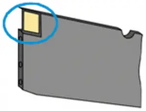

Step 4: Remove the cartridge to clean it and check for errors.
You will need a clean micro-fiber cloth, a dry cotton swab and distilled or packed water. Please do not use tap water as it contains contaminants which will worsen the situation.
  • Slightly dampen the cloth with distilled/bottled water.
  • With delicate hands, wipe the brown contacts on the cartridges.
  • Wipe the contacts with a dry micro-fiber cloth.
  • Carefully insert the cartridges back into place. The cartridges should be inserted in the same position and place where they were when you removed it.
  • Close the access flap and check the display for any error.
