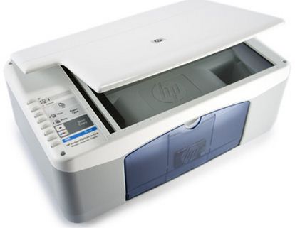

I am using HP Deskjet Printer All in One (It has a printer with a combination of scanner and copier).

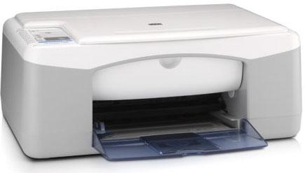

HP Deskjet F300 All-in-One Printer
Note: do not turn off and on the printer very quickly because it can cause power issue on the printer. While the printer is off, clear any pending print jobs on the computer or network. This avoids any corrupted print jobs from being re-sent to the printer when it is turned on. If this doesn’t work, try to uninstall and reinstall the driver.
Download the free version of Revo Uninstaller and install it. Once installed, start Revo Uninstaller then select your HP printer software among the applications and click “Uninstall”. Follow the normal uninstall process. When uninstall is complete, click “Scan” to scan your computer for any leftover files and delete everything it finds. This removes everything the program created on your computer.
When it is finished, close Revo Uninstaller then install the printer’s driver back. See if this works. Try also updating the driver. Go to HP Deskjet F300 All-in-One Printer series then download and install all available drivers and software for your printer. Before downloading, make sure your correct operating system is selected.
