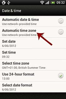

If the time on your phone is constantly changing even if you already set the correct time, try checking if the “Automatic time zone” option is turned on. It is probably what’s causing the time to change from time to time. On your phone, tap on the menu icon then go to Settings and then select “Date & time”. In “Date & time” screen, if you see “Automatic time zone” is checked, tap on it to turn it off. See image.
After this, check if the time on your phone will still change from time to time. If the problem has not changed, try checking if “Automatic date & time” is enabled. Repeat the same steps to go to “Date & time” and then verify if the “Automatic date & time” option is activated. If it is checked, tap on “Automatic date & time” to uncheck it and then check your phone again if the time will still change. See image.
