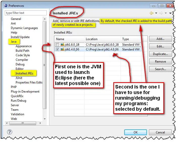

The error means that the Eclipse is trying to launch with java.exe as default which is the reference for your PATH. Always remember that you should run Eclipse with the latest JRE; you can refer the exact JRE path to your eclipse.ini and also for case for no path to update just copy JRE to your /jre directory. Launch first the Eclipse before you register the JDK. l For better and for more operation I recommend the JVM.
Have this image as your guide;
