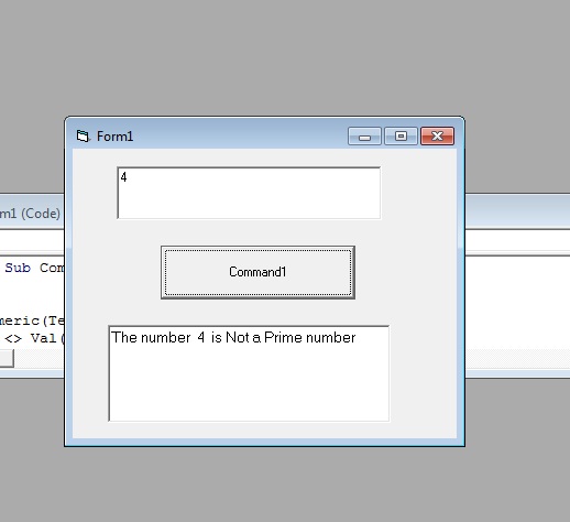

Let's give it a try
press f5 to run the program.
Enter a desired number in text1 then click the command button.
If the entered number is a prime number Text2 will display a message like this:
But when the entered number is not a prime number text2 will display a message like this:
For the validation, If you didn't enter a whole number, A message box will appear and display a notification like this:
Problem solved.

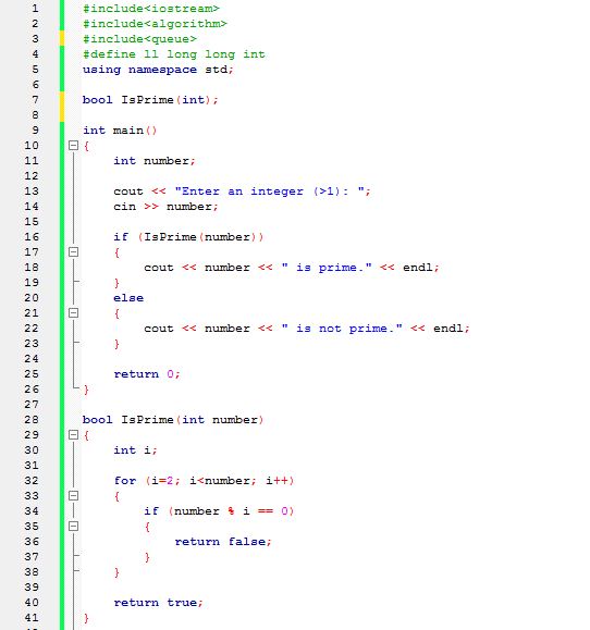

Hey,
Here is the C++ code that I wrote –Â
#include<iostream>
#include<algorithm>
#include<queue>
#define ll long long int
using namespace std;
bool IsPrime(int);
int main()
int number;
cout << "Enter an integer (>1): ";
cin >> number;
if (IsPrime(number))
cout << number << " is prime." << endl;
else
cout << number << " is not prime." << endl;
return 0;
bool IsPrime(int number)
   int i;
for (i=2; i<number; i++)
if (number % i == 0)
return false;
return true;
Regards,
Sanders Danny
