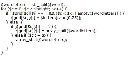

I need a php code for creating a word hunt
To make a simple word hunt or word search game using PHP, you will start with the basic. You can make a 10×10 letters in size and 10 words concealed inside. These are 5 vertical words and 5 horizontal. The first thing to do is to place the horizontal words. Just create an array of arrays with 10 elements on each array completed with periods. And then on every other array, then boost the letters for separate words. To position the vertical words, walk the entire arrays all at the same time with the use of crossword helper code to search for matching words.
