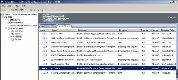

Webfilter is included on the ISA Server 2006. ISA Server 2006 webfilter is a set of DLLs that is based on IIS ISAPI Model. It is place on the Webproxy filter, the entire information will go to the Webproxy filter and this helps on identifying the events type that should be monitored. Below is an example of an HTTP Filter Add-In from Server 2006:
This is responsible for doing the following:
– Scan and modify the HTTP requests.
– Analyze the traffic on your network.
– Block a particular responses on HTTP
– Encryption and compression on your data and a lot more.
This HTTP Filter on the ISA Server 2006 will let the filtering HTTPs traffic on the opposite web server publishing situation on using HTTPS Bridging.
