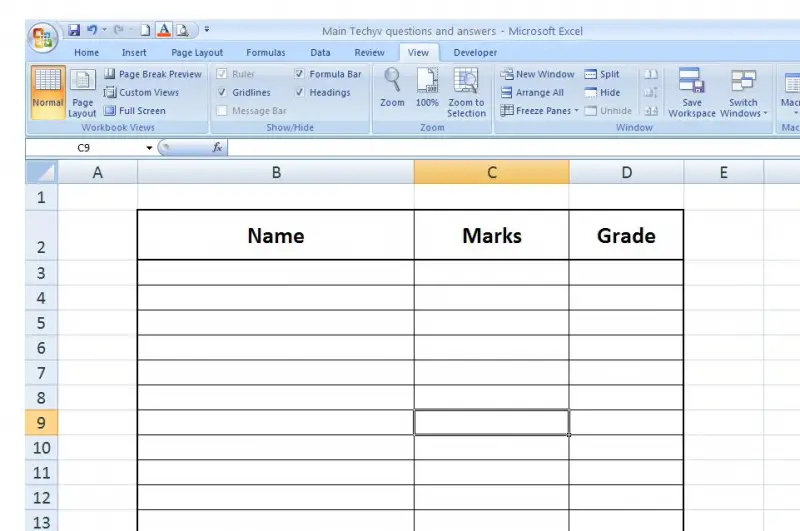

Now please make three excel columns in a excel work sheet as follows.
Then type this formula in column “Grade” and copy in down to any no of cells that you want.
=IF(C3<=25,"Grade D",IF(C3<=50,"Grade C",IF(C3<=75,"Grade B",IF(75<C3,"Grade A","X"))))
Point to note: you have to type this formula in cell D3 as shown in the following image.
Now enter marks of each person then the grade will appear according to the marks.
