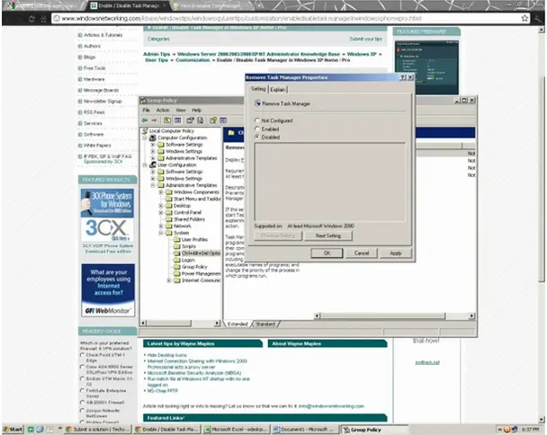

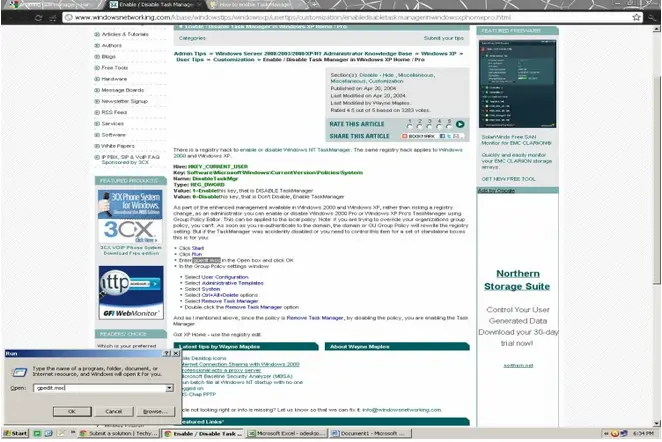

You can enable your Task Manager by following these steps:
  1. Click on "Start" button. Click on "Run" and type gpedit.msc.
  2. In the newly opened window (Group Policy Settings), click on "User Configuration".
  3. Click on "Administrative Templates".
  4. Click on "System".
  5. Click on "Ctrl+Alt+Delete Options".
  6. Double-click "Remove Task Manager' (this is found on the right side column of the window).
  7. Click on "Disable".
  8. Click "Apply".
  9. Click "Ok".
You will then have your Task Manager back.
Click on "Start" button. Click on "Run" and type gpedit.msc Click on "Administrative Templates" Click on "Ctrl+Alt+Delete Options".
