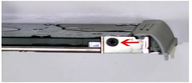

3) Then, you have to unscrew the two 3mm x 3mm screws of the hard drive.
4) After that, bring out the hard drive of the Dell D360.
5) In last, removing the caddy, just unscrew the 3mm x 3mm hard drive screw of the caddy.
