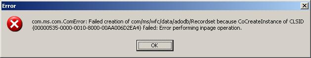

Dears, I am urdu composer and compose some books. First I use inpage 2004 and now I am using inpage 2009 I think this is latest version it has some more feature when I install this version in my system then I receive given error now I remove the latest version and again do previous version, but an error not remove.
a
Error
Com.ms.com.ComError: Failed creation of com/ms/wfc/data/adobe/Recordset because CoCreateInstance of CLSID
{00000535-0000-0010-8000-00AA006D2EA4}- failed: Error performing inpage operation.

My dear friend actually this error is an error of a file and it will never remove till you can’t remove the previous version and then again install a new version.
You told here that you reinstall it but that the error remains there. So my friend your solution is that you should first make sure that really you delete all of your old version files because sometimes we don’t know about that.
So now I am going to tell you how to delete those old files.
First of all you should delete all files from the folder where it is installed.
Now go to the control panel and then click on the add/remove program.
IN the Add/Remove you found this software named in-page old version so delete that one as well.
After following all above steps now you install a new copy and install it in any other drive for security.
