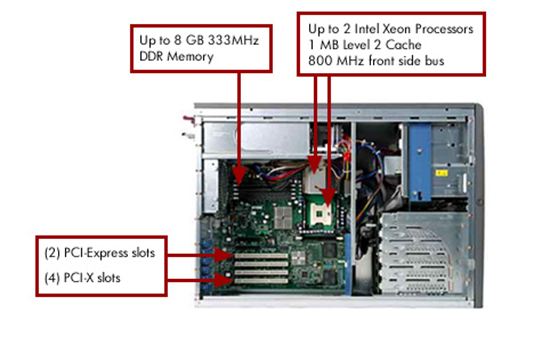

Hi. The steps to install the HP ProLiant ML350 G4 server require you to mark the rack first with the template of the rack. Then, the component rail needs to be extended. Then, press the latch and then pull the component rail continuously until it separates completely from the rail rack. Then, provide security to each component of the server. Then, install the rack rails in the rack after which the rail-release latches need to be pressed, and then the server needs to be slid into the rack. Then, the thumbscrews need to be tightened.
The cable management bracket can be secured with the help of the T-15 Torx screwdriver after which the cable management arm can be secured. Next, connect the devices to the server and then connect the cord of power to the back of the server. Then, route the cable with the help of the cable management arm after which the power cord can be connected to the power source of the AC. Hope we helped.
