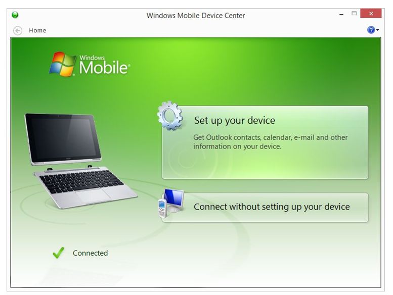

HOW TO INSTALL WMDC on Windows XP:
1) First, install ActiveSync.
2) Connect your mobile device to computer system using USB cable.
3) Download WMDC depending on the bit-ness of your system.
Windows Mobile Device Center for Windows 32-bit
Windows Mobile Device Center for Windows 64-bit
4) Run the downloaded extension.
5) Follow the onscreen instructions.
6) You will be informed about the installation by a message stating ‘Device driver was installed successfully’.
7) Press finish.
8) Open start menu and search WMDC and sync your mobile device with the system.
