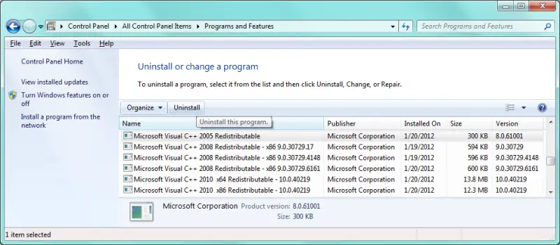

1. Please clear the prerequisite from Windows. You can find it in Control Panel.
2. From there, you should clear the prerequisite.
3. Choose: add/remove program for Windows XP and Programs and Feature for Windows 7
4. Remove the prerequisite program to be uninstall.
5. Then, the program will be clear from computer.
6. Finally, you should try install again.
