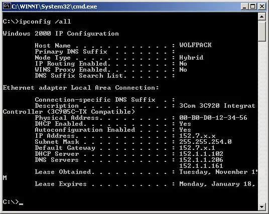

Hi Roslin.Miye,
I hope this will solve your problem.
Making Sure You Have Correct IP Information.
1. Make sure you have the correct IP scheme for your network. This would include the:
IP Address
Subnet Mask
Default Gateway
DN S Servers
There are a few ways you can see what IP addresses are being assigned. But generally for:
Win9x – Start / Run / command
Wi ndows 2000/XP/Vista – Start / Run / cmd
2. IP Address: If you have a router, common examples would be:192.168.0.x, 192.168.1.x or 10.0.0.x. If you are directly connect to your DSL or Cable Modem, you should have an IP address that would correspond to something from your ISP. What you don't want to have is something like 169.254.x.x. This means you are not getting and IP address assigned and needs to be resolved first.
3. Subnet Mask: Also make sure you have the correct Subnet Mask. Most commonly this would be 255.255.255.0
4. Default Gateway: Make sure you have the correct Default Gateway IP address. With a router, this is typically the IP address of your router.
5. DNS Servers:Make sure you have the correct DNS Servers.
Sometimes this is the IP address of your router, so it would be the same as the Gateway IP. Sometimes (as in this example), it is the actual DNS servers used by the ISP.
