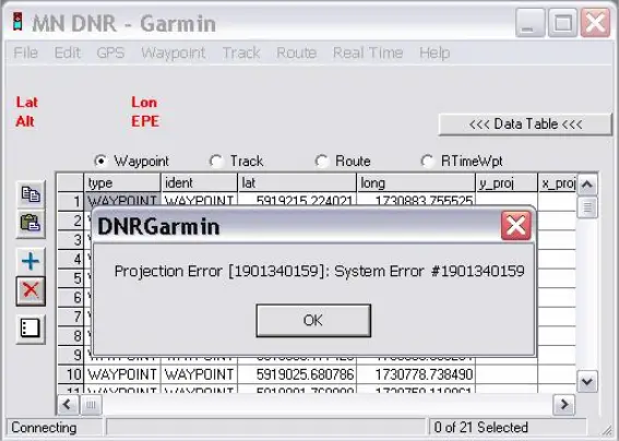

The other option was to use DNRGarmin to open the files, I tried using it, but each time, I was met with an error. The screenshot of the error is as follows:
DNRGarmin
Projection Error [1901340159]: System Error #1901340159
OK
When I press OK, I get both the columns of X proj and Y proj, but they are filled with the latitudinal and longitudinal fields.
