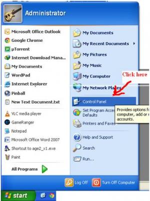

You can go to the Start -> Control Panel,

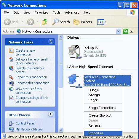

Then click on Network Connections.
Right click on the local area connection and then choose Properties.

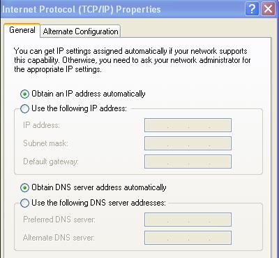

Click on the General Tab and then move your mouse a little bit down in the list box and then click Internet Protocol (TCP/IP) and highlight and then click Properties.
Now select Obtain an IP address automatically as well as Obtain DNS server address automatically..
Now click ok. I hope this time you will succeed in renewing your IP address and will get rid of this problem which has caused you a lot of problems in doing your work.

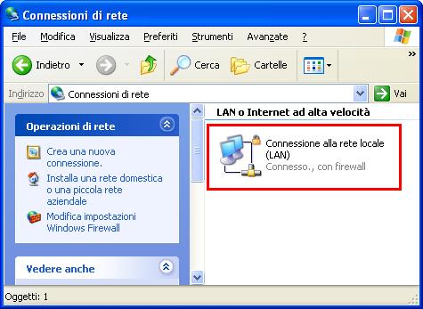

Here’s how they do it. Go to the local area connection on the taskbar and it will display the local area connection status, and click the properties button.

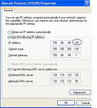

In the internet protocol (TCP/IP) properties and they will change the 4th Block of the IP address and after that press ok and close the program.

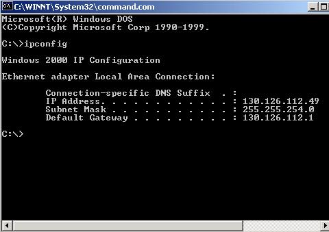

The next thing to do is open the command prompt and they will type ipconfig and clicks enter.
If the result is like the image below, then the IP that use is unique and never been used.
But if the result is like the image below, then the IP is already use. And it should repeat the entire process to have a unique IP address.

To change IP just right click on "my network places" and it will show your network connection. Double click on it and do as shown in these pictures.

Now change your IP address.
