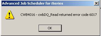

There is a problem when accessing the Advanced Job Scheduler using the iSeries. The error returned is as shown in the image. I am using it to process job without supervision from day to day.
Error message:

This problem is caused when trying to access the Advanced Job Scheduler using iSeries Navigator.
To resolve this problem you have to delete the QIJSCA data queue using the  command: DLTDTAQ QSRIJS/QIJSCA.
Then close the iSeries Navigator and reopen it.
The data queue is created again when the Advanced job Scheduler can be accessing
The error should be fixed
