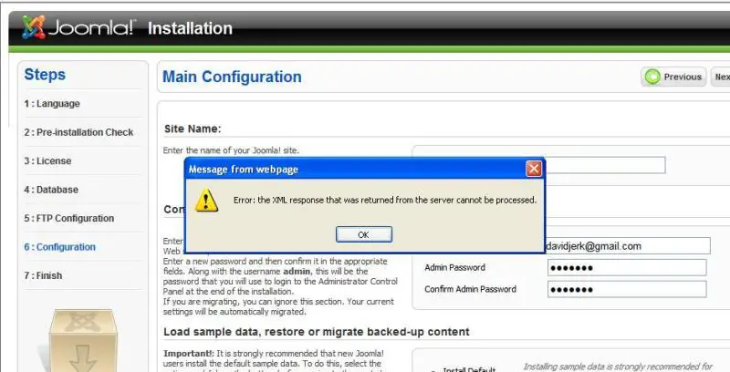

I have installed Joomla version 1.5 on my system and it went fine to the point of creating sample data. I am running this on Windows XP. Please have a look at the error and tell me the solution. Appreciate your help. Regards.
Error:
Error: the XML response that was returned from the server cannot be processed.

Hi Mildred, check that the following are correct, on Database settings put Username:root password:leave it blank then under FTP configuration just leave the FTP setting they way they were(do not put anything). An error is as a result of either the above settings i prefer you used v1.7 or the latest version. Thanks let me know if this was helpful and do not hesitate to get back to me if you get a problem
Answered By 5 points N/A #92064
Joomla v1.5 installation error in Windows XP
This error comes out from your Joomla! installer that could not process an XML response from your server. To fix this, try the following workarounds:
1. Modify the advanced setting on your Database Config page and change it to a non-default radio button. Do not back up your old Joomla table just drop the table and perform a fresh install.
2. Try renaming the configuration.php-dist into configuration.php.
3. Edit the file /installation/sql/mysql/joomla.sql or /installation/sql/mysql/sample_date.sql file and change it to TYPE=MyISAM to ENGINE=MyISAM.
