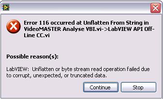

I am trying to keep a file which I made for using Lab View but I faced a problem which showed the following error message.
"Error 116 occurred at Unflatten From String in Video MASTER Analyze VBI.vi->Lab VIEW API Off-Line CC.vi.
Also I found a possible reason message,
"A possible reason (s): Lab VIEW: Unflatten or byte stream read operation failed due to corruption, unexpected or truncated data."

Error 116 occurred at Unflatten From String in VideoMASTER Analyse VBI.vi->LabVIEW API Off line CC.vi
Possible reason(s):
LabVIEW: Unflatten or byte stream read operation failed due to corrupt, unexpected, or truncated data.
Continue Stop

I think there is a problem with the file you are trying to open with LabVIEW. I’m not sure if the problem is with the file you are trying to open or with LabVIEW itself. Try checking your computer first for any possible errors.
Maybe the problem is in the hard drive. Use a disk utility application to check the system. For a much thorough diagnostics on the system, use a disk utility application like Norton Utilities, Norton SystemWorks, or PC Tools Performance Toolkit.
After checking your computer, try opening the file again using LabVIEW. If it is still not successful, try uninstalling the application this time and then install it back.
This will fix any corrupted files in the installation and will restore its settings back to default including some that you might have customized.
