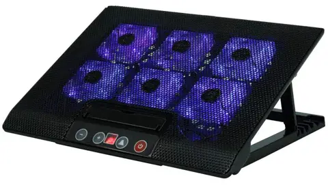

In case you are not satisfied and you think your laptop is very hot for you, you can purchase something called cooling pad for laptop. Sometimes the cooling system designed for a laptop is not enough especially if you are using applications with heavy graphic requirement. Because the cooling system is not enough, the machine sometimes shuts down untimely. And this can cause data loss on your side.
