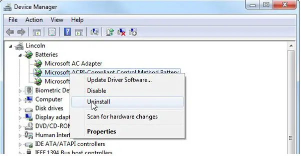

1. For Windows Vista, go to the Start Orb, then on the search field just type in Device Manager. If you are using XP, just click on the Start Menu, go to Control Panel >> System >> Click on Hardware tab then Device Manager will be the first button.
2. Once you have Device Manager opened, search for the field which says batteries. Just click on the plus sign next to Batteries to expand the menu.
3. Look for Microsoft ACPI Compliant Control Method Battery, right-click it then select Uninstall.
CAUTION: Do not remove any driver especially the Microsoft AC Adapter driver or anything which has ACPI.
4. Next, go to the Device Manager Taskbar and click on the Scan for hardware changes. You can also access it through Action Menu.
5. Windows will now scan for any hardware changes and install the missing drivers. You may now reboot your PC and see if it will charge.
