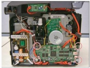

As the statement justifies, this error occurs when the top cover or the front cover of the printer is not closed properly. But if you have done that already, there might be some other problem. Sometimes the transfer belt of the printer is not installed which gives rise to above error, or the harness is defective.
To resolve this, check whether the PTB is installed in your device or not. If not, install PTB. Also, check that the harness between HVPS and PBA is not broken or defected. Doing this would probably resolve your issue.

If you encounter this error on a Samsung printer, check and verify that the door is perfectly closed. Another possible cause of the problem is a defective door sensor. In this case, check the cover open switch on the HVPS and verify that it is operating properly. If there is a problem, replace the HVPS board.
This method is beyond a normal user’s capacity to fix basic problem. If the problem continues, just bring the printer to a repair shop to get it serviced.
