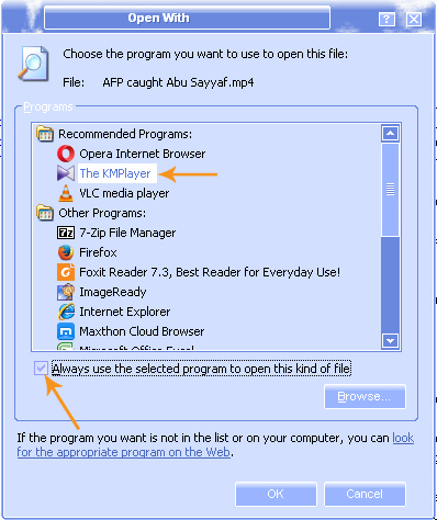

That error is actually not a problem with mocha but has something to do with the file association on your computer or with how the files are associated with After Effects and mocha. Though mocha is not a plug-in for Adobe After Effects, it must be started from within Adobe After Effects and will not work outside Adobe After Effects.
The reason why the error was triggered is that mocha was launched directly or outside After Effects. That only happens if there are files directly associated with mocha. When a file is associated with mocha, it will automatically start mocha when you double-click the file. When you associate a file or a file type to a program, you are also setting the default program to launch it.
And in the case of mocha, it is not possible because mocha is not a separate application and you cannot launch it directly. It has to be launched from within Adobe After Effects. To fix the problem, you need to change the file association on your computer. Find video files that are associated with mocha, right-click the file, point to “Open With”, select the application or select “Choose Program”.
On the dialog that pops up, select the application you want to set as the default media player for that video file type. Check “Always use the selected program to open this kind of file” and then click “OK”.
On the other hand, if you want to edit the file with mocha, start Adobe After Effects and then start mocha from the menu.
