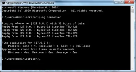

1. Open Command Prompt >> Start >> Run >> CMD & PING your server hostname.
A typical IPv6 retort for localhost loopback, if the NLM is exist on the same machine. These will be like that
::1
.a full IPv6 address such as 3ffe:1900:4545:3:200:f8ff:fe21:67cf
2. If you see the response is like above one, disable IPv6 on your network and very PING to be sure that IPv4 address is like “xxx.xxx.xxx.xxx” this format.

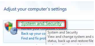

To disable UAC in Windows Go to Control Panel>> select System >> Security.

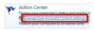

Select UAC setting:
To disable the UAC setting select “Never notify me when”.

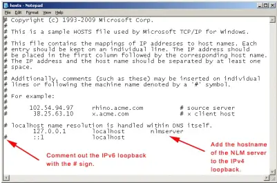

2. Find the file from “C:Windowssystem32driversetc”
3. With Notepad open the HOSTS file.
4. If you see file is Reading only, go file properties dialog box and create the file writable.
Then you can your HOSTS file will be similar to the example below.
Your NLM & Autodesk product are exist on same machine”
1. Comment out the IPv6 localhost address of ::1 via adding a # mark.
2. Then behind the IPv4 localhost 127.0.0.1 address add your hostname.
3. Save File>> close Notepad.

2. To verify IPv4 open Command Prompt as well PING the server hostname. When your NLM is local you can see 127.0.0.1 and IP address will display if the NLM is on a server.
3. Finally after launching your Autodesk product it will launch & get a license as appropriate.
