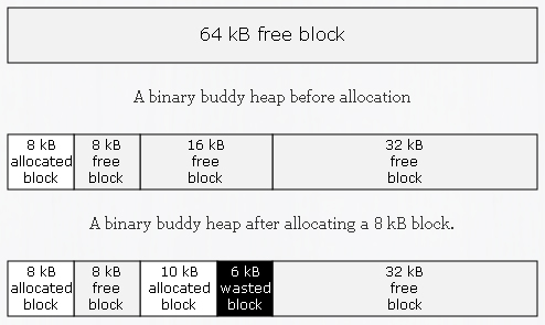

Memory allocation is the process of designating chunks of memory on request. The allocator normally accepts memory from the operating system in a small quantity of big chunks in which it must divide up to fulfill the requests for smaller chunks. Any returned chunks should also be made available for reuse.
There are several common methods of performing memory allocation with various strengths and weaknesses and several of them are the following:
Also, these methods can be used in combination. In the first fit algorithm, the allocator maintains a list of free chunks which is known as the free list. When it receives a request for memory, it scans down the list and looks for the chunk that is big enough to satisfy the request.
If the selected chunk is considerably bigger than what is requested, it is usually divided and the remainder is added to the list as another free block. This algorithm executes quite well because it guarantees that allocations are swift. In a buddy system, it will only allocate chunks with specific sizes and has lots of free lists, one for every allowed size.
When a request for memory is received by the allocator, it rounds the requested size up to an allowable size and returns the first block from that size’s free list.
