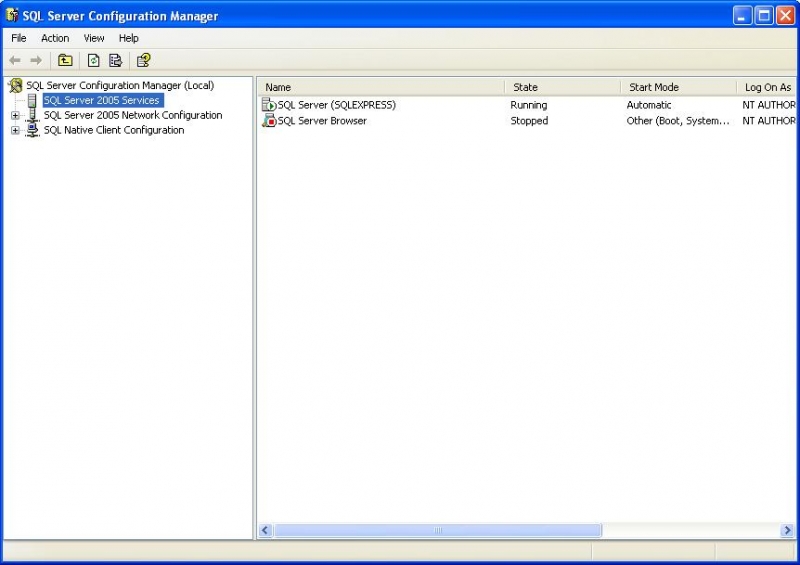

After verifying that instance name is correct, the sql service is running then this is how we allow remote connection in sql server.
On the configuration tools select Sql server configuration Manager.

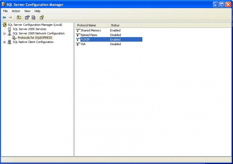

Select SQL Server Network Configuration and select the Protocals for your named sql server instance then TCP/IP.

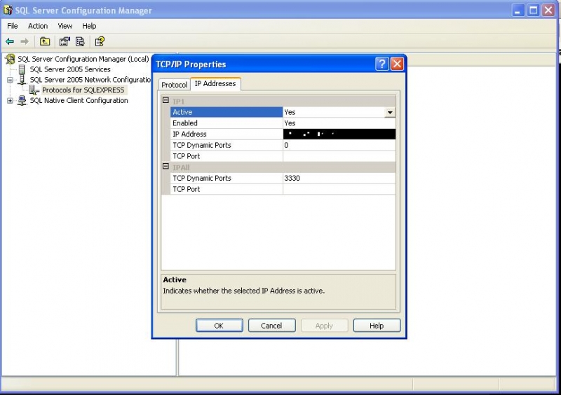

Then Double click on TCP/IP – Protocol  and make sure that Enabled is Yes. On the IP Addressess Tab Make sure that Enabled Is Yes.
Apply and the Restart the server.
Try connecting to the sql server and the problem will be solved.
