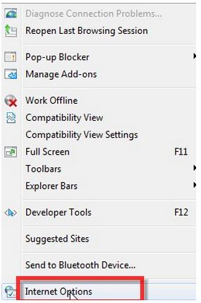

**press alt + t+ o (it’ll get you to internet options).

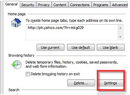

You’ll see this screen,
Click on this button.

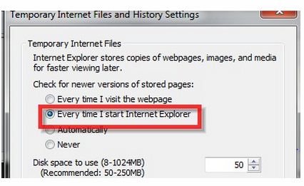

Choose the one highlighted. And restart your pc.  That should do the trick for the meantime.

But you can still be able to access the VPN as well as check your mails without an issue. That implies that the circuit is still up and unaffected. Investigating the logs I found that the line had not disconnected once. I will suggest that you try the following workaround:
Try setting the Internet Explorer’s caching settings for systems so that they will not be able to check “Automatically” for new pages.
Instead they should check on every start up of Internet Explorer.
