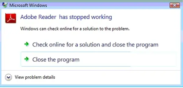

My Acrobat Application Crashed On My Windows
Mention the solutions to resolve the Acrobat app crash. Describe the error message that comes during the crash of the application?
The error message display ‘The instruction at 0x5fc785ad referenced memory at 0x00000000. The memory could not be read. Click on OK to terminate the program.’
