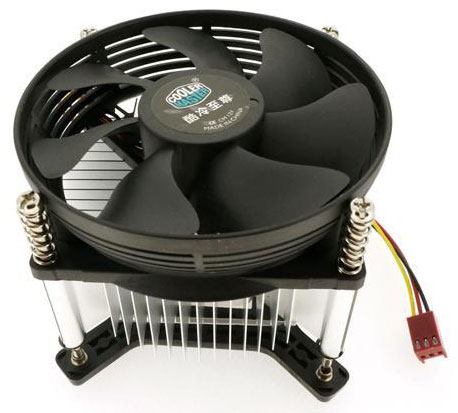

If you are using a desktop computer, the only reason why it would shut down by itself is overheating, nothing else. Other problems you may encounter with your computer related to hardware may cause the machine to automatically restart.
CPU or processor cooling fan
When a computer shuts down by itself, normally, you may see a message on the screen during the BIOS POST screen that the cause of the previous shutdown is due to “thermal” the next time you start the computer.
If you see a similar message on startup on the BIOS screen, you need to check your CPU cooling fan because it is a sign that it is failing or there is a problem. When the temperature of the processor is rising, it is the job of the BIOS to adjust the spin rate or cycle rate of the cooling fan.
If there is a problem with the cooling fan and it is not operating normally like it spins slower than normal, the adjustments being made by the BIOS will not work. When the temperature of the processor continuously rises and it reaches the limit, the system will shut down automatically to prevent damage to the processor and other hardware components.
In this case, you simply need to replace the CPU cooling fan to restore the system back to normal. Now, replacing the cooling fan is easy but it comes in sizes. Purchasing a cooling fan with an incorrect size may not fit the chassis and you will end up wasting money.
To avoid this, bring your CPU to a computer shop or computer store to help you look for a compatible cooling fan.
