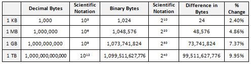

Determining the capacity of a drive confuses at times because the measurement standards often used are different.
The reason as to why you system is not displaying 160 GB instead of 149.04GB is because there exists two different systems of measurement i.e. using decimal values where numbers are in base 10and also using binary values where numbers are in base of 2 .
For the sake of consistency and keeping it simple, 1mb is defined as 1 million bytes while 1GB is defined as 1,000 million bytes by the manufactures of the hard disk. This measurement is in the decimal format which happens to be the official industry standard. However, some system FDISK, BIOS, Windows and Mac equate a megabyte to 1,048,576 bytes while a gigabyte is equated to 1,073,741,824 bytes, this measurement is done in binary mode.
To determine capacity using the decimal mode, divide the total bytes by 1,000,000,000(this is the number of bytes that make up a gigabyte in decimal standards).
To determine capacity using the binary mode, divide the total bytes by 1,073,741,824(This is the number of bytes that make up a gigabyte in binary standards).
Because of this reason, you fill find out that different utilities give varying capacities yet it’s the same drive. The bytes will always be the same but when it comes to gigabyte it depends on which standards were used. This is the same to how 0 degree relates with a Fahrenheit of 32 degrees. The temperatures are the same but the scale in use depends the answer you get..
From the way you have described your problem; your computer’s operating system is displaying the hard drive capacity in binary form. By this I mean that the capacity indicated on the drive is the same as the one displayed by your operating system and no memory has been lost in that case.
Study the image below so that you can better your understanding further and be able to come up with a viable and logical conclusion.
