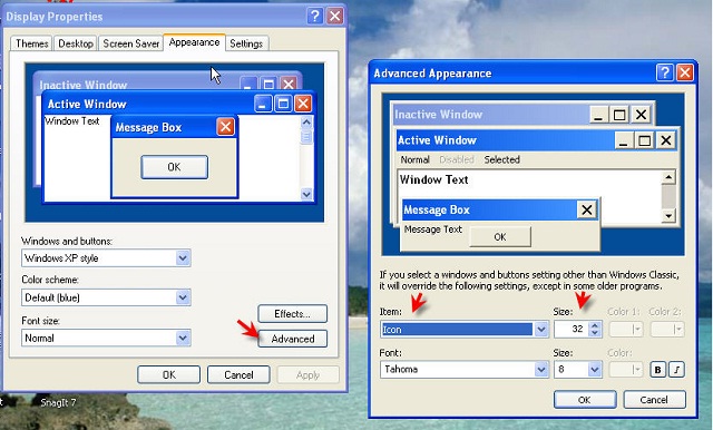

Ok I am presenting the solution you have to do following things to resize your task bar it is simple and will work fine:
  • Right click on desktop and select properties select APPEARANCE tab and.
  • Under this tab click Advance and you will see different options here.
  • Now you have to choose task bar from here and you can change the size of your task bar.
  • I have do this for you in the given Picture.
  • You can also change fonts and other things for your requirements.
